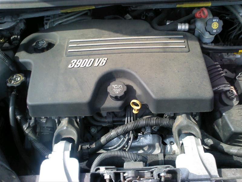

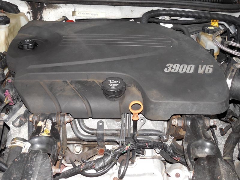

Post a pic of the engine bay?
#15 ·
Okay,
i.imgur.com/QRG1V8e.jpg
i.imgur.com/uESt6kU.jpg
i.imgur.com/tFErkmI.jpg
i.imgur.com/2nNJe48.jpg
so what do ya think?
cause this is what i found on google...
http://i.ytimg.com/vi/G8eewd56IjY/maxresdefault.jpg
http://images.hollandersolutions.com/ACI/CT7/IFZ/CKH/4.jpg
http://static.cargurus.com/images/s.../site/2015/01/04/19/52/2009_chevrolet_impala_police-pic-379473042129232967.jpeg
http://cimg.carsforsale.com/394405/E3868AFC-AD1C-4D49-826E-B817CAED39CA_8.jpg
Mine never came with an engine cover so idk whats what lol, obviously not the last one but, I just recently learned there were more than one version of this thing...

See this is a rough one because about 85% of the 3.5L and the 3.9L is identical.
#19 ·
Well on some 3.5L there were air resonation pipes on the intake which this one lacks but, it's not a definite tell-tale.. I was hoping to see a cover.. LoL
