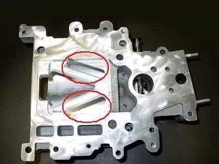

IMO, waste unless your going to tap it and use it to spray meth/no2. In theory its a great idea, keep the tb off the hot blower and keep it cooler so your air intake temps stay lower, but AFAIK, no one has seen any real gains from it. If you really want that blower to scream, take it off, and block off the silencer ports (circled)
ps thats a gen V w/o the snout incase you were wondering why it looks different
