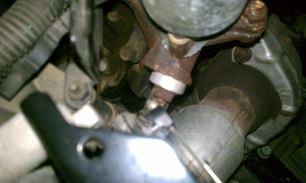

hey guys i was cleaning the throttle body yesterday and when i was putting back the second cable on the throttle the little black clip is broken. here is a pic of the cable i am talking about:
now my question is that i don't know what the cable is for. i know the other cable is for the foot pedal but not the second one for what i broke. i think its for start up i think. can someone help

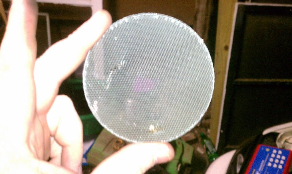

now the second question is that when i was cleaning the throttle body i found this honey comb filter on the TB and it has dents and dings in it and i know that if messing up the air flow and was wondering where i could get a replacement part. here is some pics:
Is this the 3800? If so, ACdelco part number 2171425
Rockauto.com has them for $18

well thanks for a quick response i tried looking up that screen locally but could not find one so i ordered the one from rockauto. thanks for the look up.
and i need to replace that clip but for right now i just have it holding on by zip ties. so i tried looking up on rock auto but could not find one. what would this part be classified under?

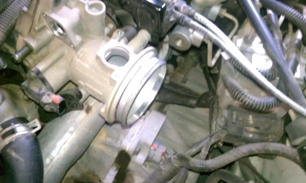

well i did not take off the TB fully because i was running out of time but before the flap is all really clean only dirty part of course is after the flap but it did not look that bad. and plus it feels like its sticking too when you open the flap with the throttle cable
Could be a faulty Idle Air Control or Throttle Position sensor giving false readings. Did you take the IAC off? Was the pin stuck out? If it was clean it and see if it move's. If it doesn't, replace it. Do NOT force the IAC pin back into the valve.

oh sorry i meant to say that earlier but i did change out the IAC. but i have not tested the TPS yet still looking for the cruise control cable replacement
It isn't the same throttle body issue as the 8th gens, the 8th gen is an electronic drive-by-wire, the 7th gen is traditional cable operated. That being said, it could still be a tps issue.

no look at the second pics thats the cruise control cable holder that broke i need to replace it because now i don't have cruise control. and i don't know where to get the cable from
