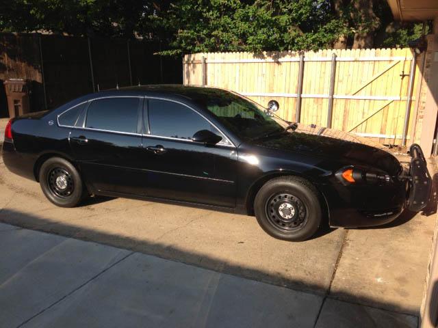

So I've had my 9C1 for about a month now, and I wanted a way to improve the looks and handling while still keeping the "police car" look. I decided to get the Charger police issue 18" black steelies.
The set I got came with the polished "moon" center caps, but I prefer the original Chevy center caps. So, before I had the tires mounted I drilled and tapped the Mopar wheels so I would be able to bolt the Chevy caps to it after they were mounted. This was a bit tricky since the Mopar wheels have a curve right where the bolts needed to go, but we got it done. I went with a smaller 1/4 bolt (with a washer) to give myself some wiggle room when mounting the caps.
I decided on 245/45/18's since they are the same overall diameter as the original 225/60/16's.
Before:
After:
I know the pics are crappy, I will try to get some better ones soon. I like the look, but the wheels are a tad wider than I was expecting. If you look from the top of the fenders, the wheels are flush or just narrower than the fender. However, due to the curve in the Impala body, from the front and rear they look a tad wide. I'll live with it for a few weeks and then decide if I need to change the wheels to something else. I am not finding many options in 18" black steelies.

Looks way better, I want Charger police my self.... not sure why those tires looks bigger then 245/45, more like 245/50 or even 55.

Does look more beefier. I like. Most charger wheels offsets are wider. I believe its +27 offset. Mine stick out aswell but makes the car sit more flush imo.

You had me wondering the same thing. I knew what I ordered but hadn't looked at the sidewall to make sure they put the right tires on ;) I just double checked and they are in-fact 245/45. I was considering doing 235/45 but I doubt that would have made a noticeable difference. When I've done 18s in the past on my Grand Prix's I used 245/40 but those cars were lowered and I was worried it would leave too much fender gap on the cop car.

Do you get tire rub in the back when hitting a bump?
YES! I've never had tire rub in a w-body that wasn't lowered so that was a surprise. I did a quick fender roll and it made it better but I need to take the wheels off to get it completely rolled. I need to replace the parking brake shoes so I figured I would do a better roll at the same time.

I thought so. Did a fender rub and got a small spacer bcuz mine rubbed on the brake caliper. I recommend 235/45/18s for the front and 225/45/18s in the rear. I get no tire rub.
