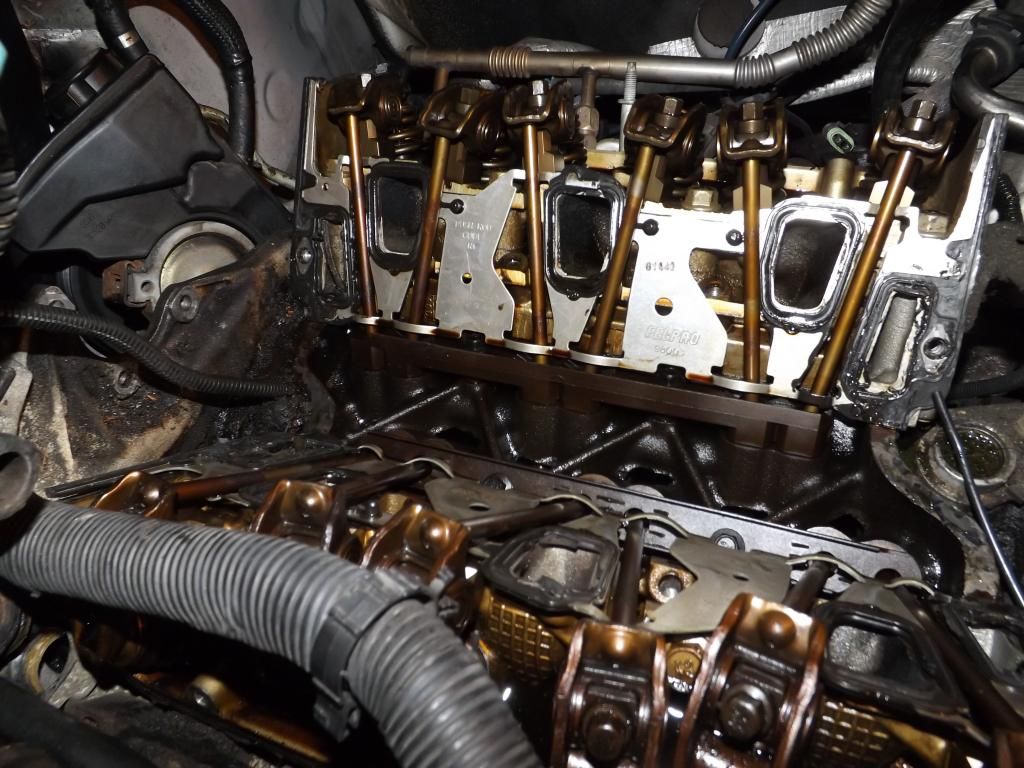

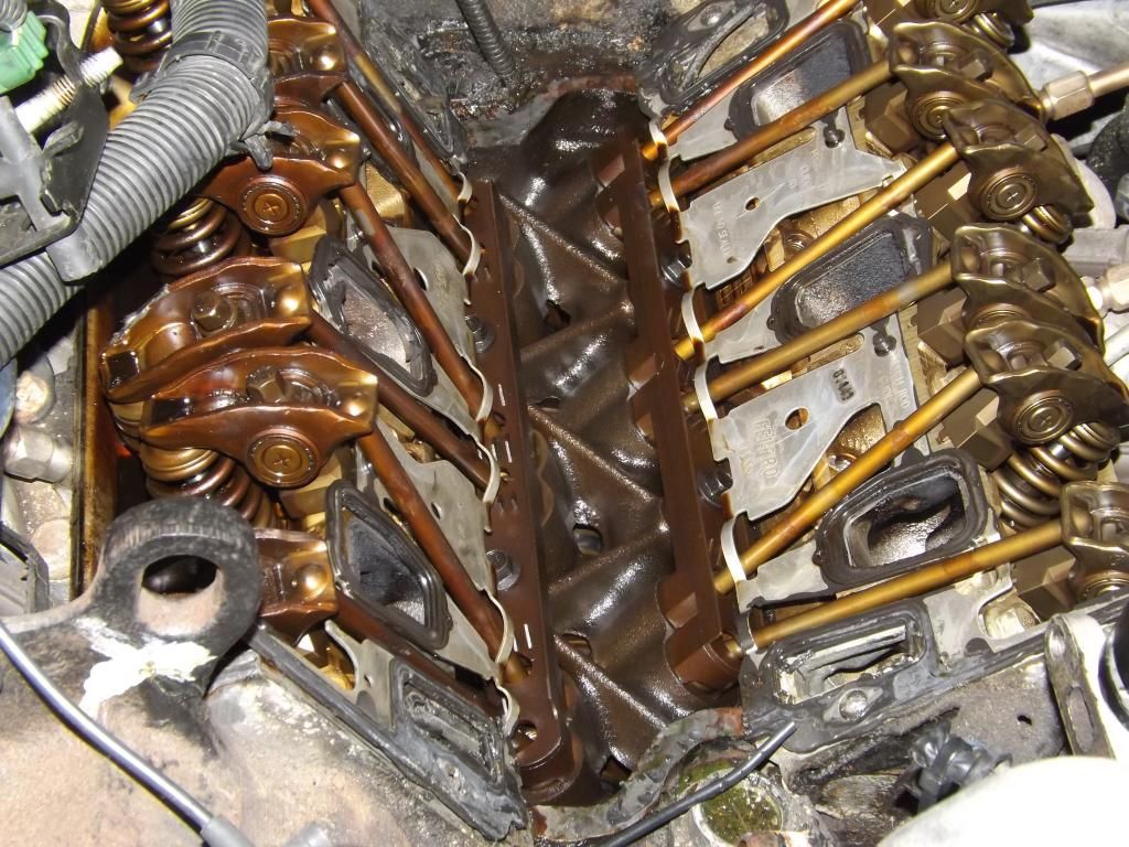

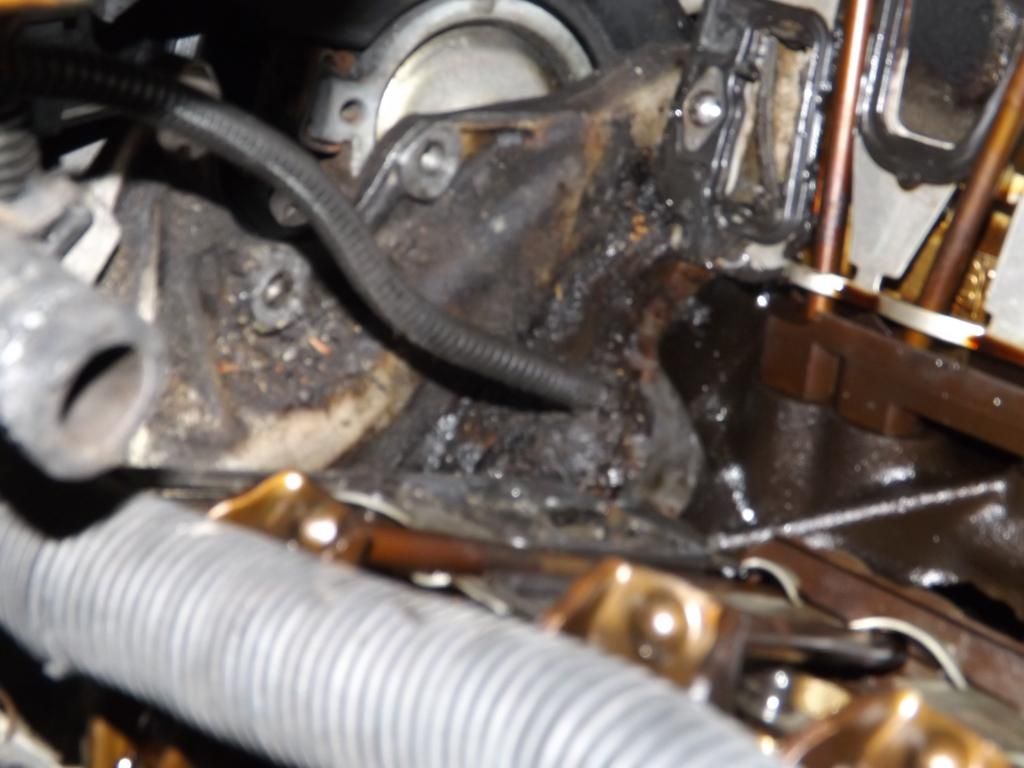

I had an overheating problem with my impala where it would overheat in 5 minutes of driving. Went into the engine to remove the lower intake manifold realize it seems the gasket change to fel-pro was already done. Only thing I notice is that the engine had a lot of gunk do you know where it could of came from? Do you think my overheating problem could of came just from the radiator?
Back in Black
4,127 Posts
good find wonder if it cracked when car overheated or before.
Yikes! Better take a look at the heads while you're in there too, they may be cracked or warped as well.
Lower manifold will be fairly cheap from salvage, the heads you will need to find out if they are bad or not. And the block for that matter.
17 Posts
I bought a lower intake manifold on ebay should be coming in the next couple days. Went to work on the car today and found a piece was missing out the head. More money coming out my pocket.
10,950 Posts
Sounds and looks like it could turn into a money pit pretty quickly.
At some point ( you may already be there ) you have to make a decision to "pull the plug" on this motor, or the car. Not sure what it is as far as year, mileage, condition etc.
Might find a donor motor in a wreck someplace and transplant, otherwise, cut your losses and move on.
As King stated. You could get a set of heads, manifold, etc etc put it all back together and find the block pooched.
From the looks and sounds of things it's been pretty hot.
IMO that is
