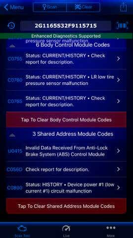

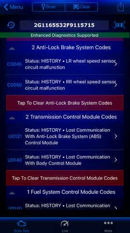

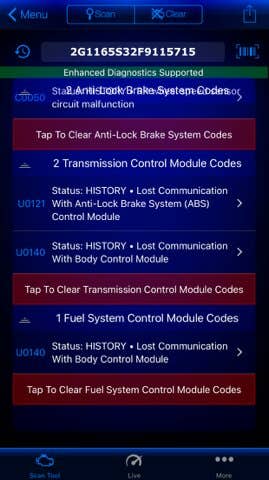

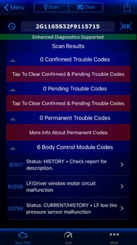

In the meantime, a coworker had an obd2 reader, and pulled the stored codes in my car. Looks like a bunch of bcm issues.

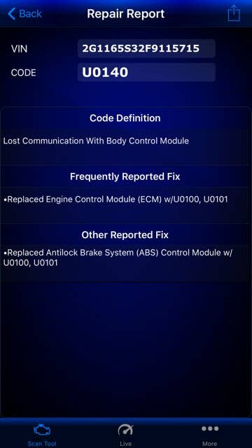

Sorry that unplugging the side detection modules didn't bring things back. In doing some more research there is an HMI, human machine interface, module update that fixes a lot of issues, from blank screens to phone connectivity issues. The update is for HMI module build versions older than gmg2_14.0f105. Press power + menu + home to bring up The version number screen. The TSB is PI1375C. On code U0140 there is a tsb#PIT4730B that has you look for shorts in the high speed GM Lan circuits (2500 & 2501) witch have experienced an intermitent short to ground while going over bumps.
