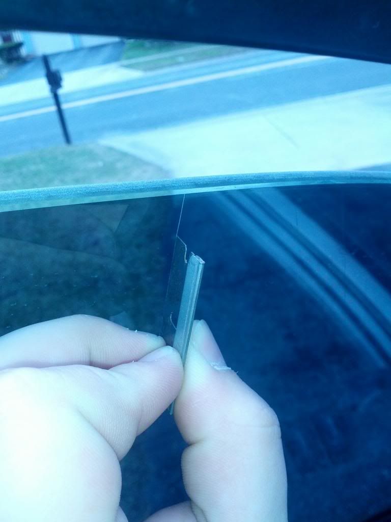

Roll the window down ~2 inches and cut a slit in the top of the tint with the razor blade. I found it helpful to separate the tint into 3 or 4 sections.

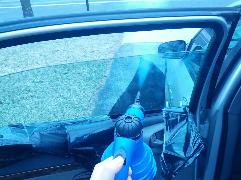

Use steam from the steam cleaner to heat up the area around the slit, and move the razor blade under the edge of the tint, to lift it up.
Step four:
Use steam around the area of tint you just raised with the razor blade. Spray a good amount of steam on it to get the glue to warm up. Start pulling on the raised area of tint with your fingers.
Step five:
Slowly pull down a section of the film as you continue to spray steam on it. Be careful not to burn yourself. You can spray, then pull until you get a good enough piece going, and then spray continuously as you pull. Be careful to go very slowly, and watch the tint as it peels away from the window. The tint can leave small amounts of glue if not steamed enough. The tint also likes to come off about 1/2" very quickly (It will sound like pulling tape off of something) and this can leave glue on the window as well. Pull the tint until it reaches the bottom of the window.

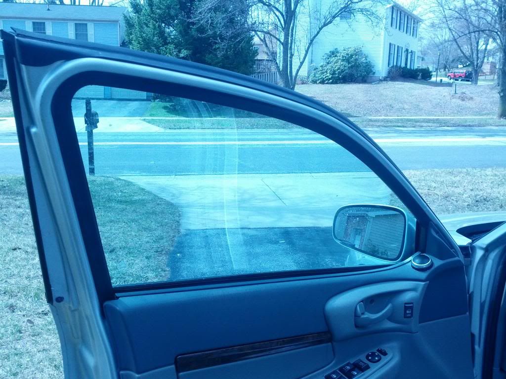

Before:
Finished:

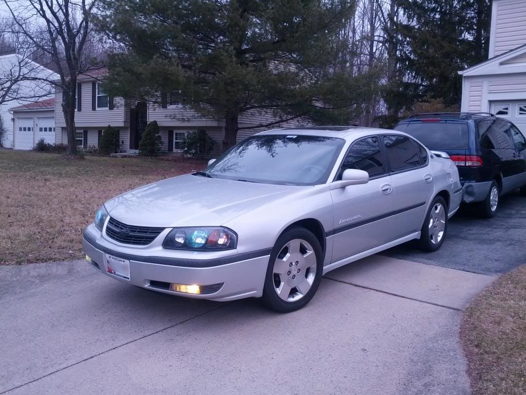

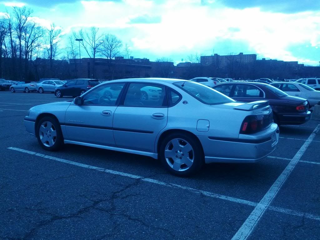

I have to add I did have tints on my windshield 50%. Opps, I guess that's why I got pulled over, lol.... NOT, the cop didn't even notice it just at the inspection station they did.
This when it had 20% tint and 50% windshield on 20's:
I miss this look.
