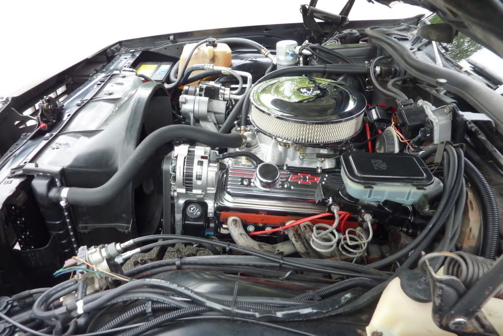

how hard would it be to convert my clutch fan over to an electric fan? i have the towing package , so i have one small electric fan already. the reason i am asking is because i found two cracks in the "clutch Fan and coolant pump bracket" and it seems to be a difficult part to find.

your engine looks great by the way.....
