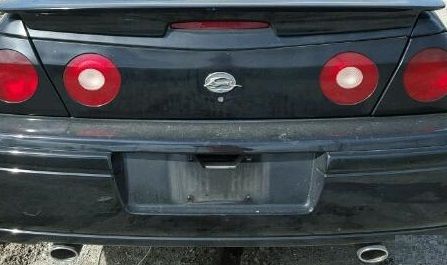

I would say if it was me and wanted to have this done. I would go to a Exhaust Shop and ask for a SS Exhaust from headers back. Seeing the cars have the same motor unlike the 06-09 that has a V8 It would cost more then the normal LS seeing there will be a Y pipe towards the back and extra pipe from there back.... You know the funny thing is I was looking over some Impalas not that I don't have enough now but I seen this one car that I was going to ask about some thing I have seen now on 2 cars from the same area maybe was same owner for all I know lol.... But one of the cars was a Silver LS and it has dual. From the stance of the tips it looks like it wasn't the same setup as the SS because they sit outside of where the SS pipes sit....
This picture is of a SS
This picture of an LS with dual Exhaust.

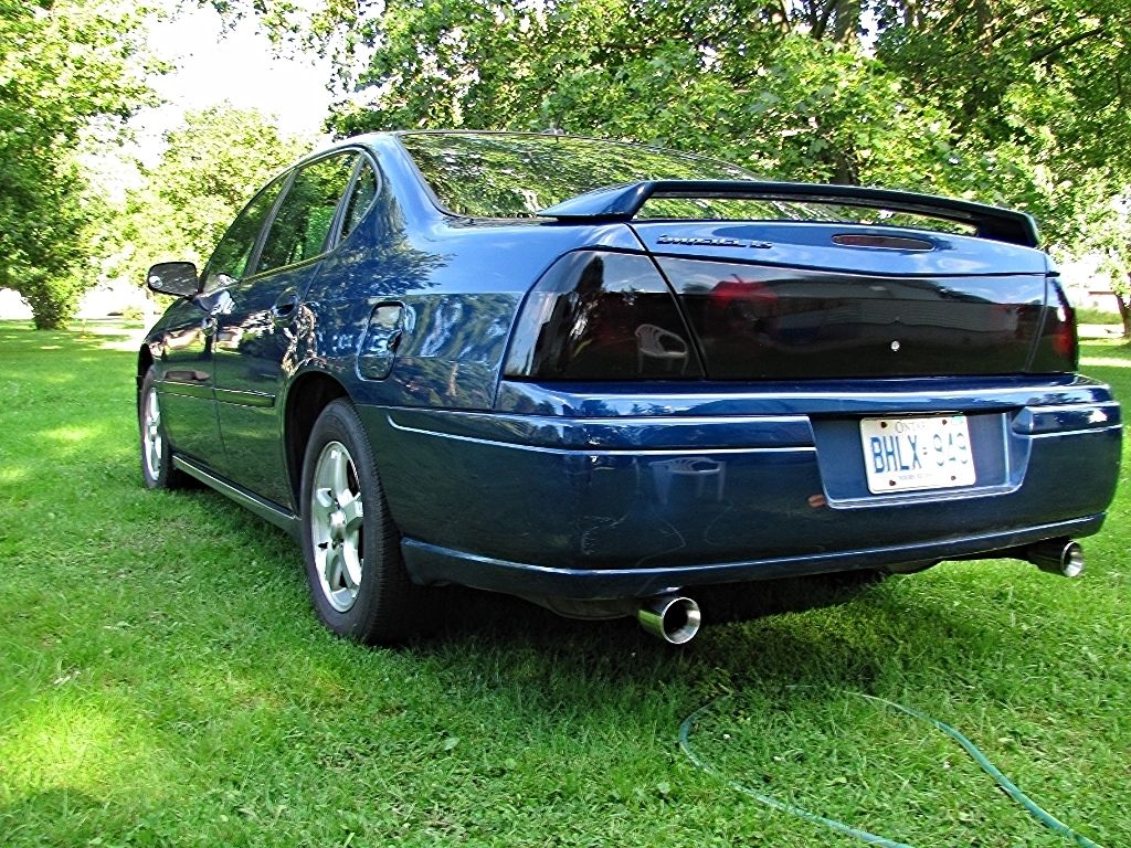

Alright, here they are!!! Again, I'd like to thank everyone here for the help! It was great to hear all of your input on this topic. I'm loving these pipes so far!
