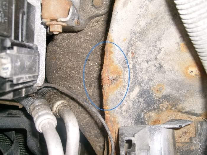

Well, we finally got some decent weather and I decided to dig into my ABS warning lamp issue (in which the ABS fuse was good). All my sensors appeared okay, until I started digging around the ABS connector at the pump and found this problem:
So if y'all b-body owners get a chance, take action and protect those wires! I was able to repair 4 or 5 wires and the system works great again...
They were rubbing up on this portion of the wheel well:
