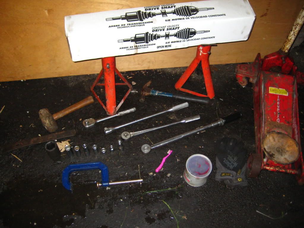

Things you will need
- jack
- jack stands
- breaker bar
- ratchet
- torque wrench
- Sledge hammer
- regular hammer
- pry bar
- 35mm socket (36mm will work too)
- 15mm socket
- 13mm deep socket
- c clamp
- 3/4 inch socket
- 5/8 inch socket
- high temp bearing grease
- grease applicator (tooth brush or paint brush)
- drive shaft
- mechanic gloves (grease is messy)
- wire clothes hanger (not pictured)

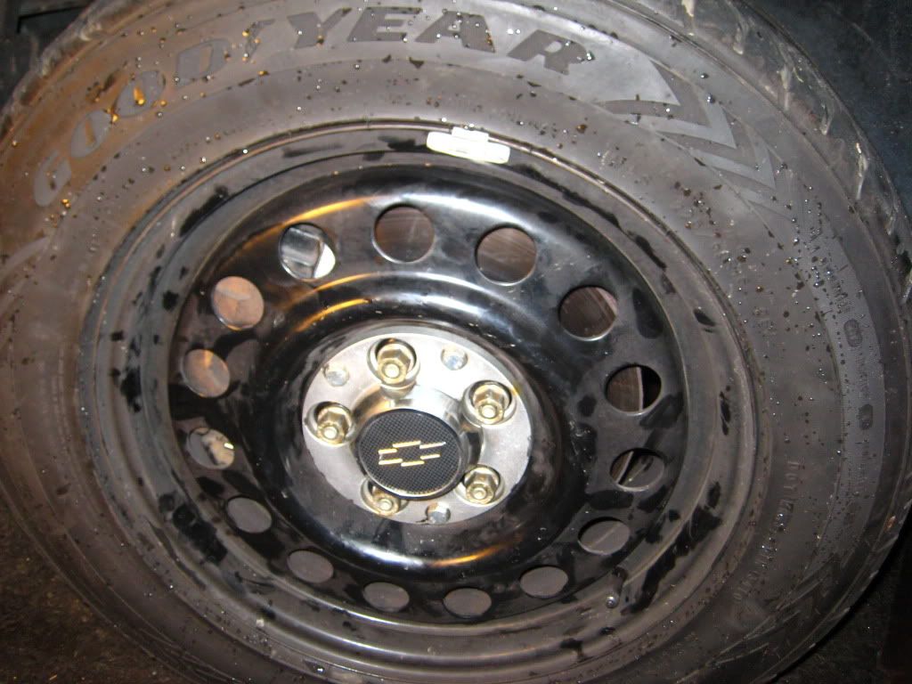

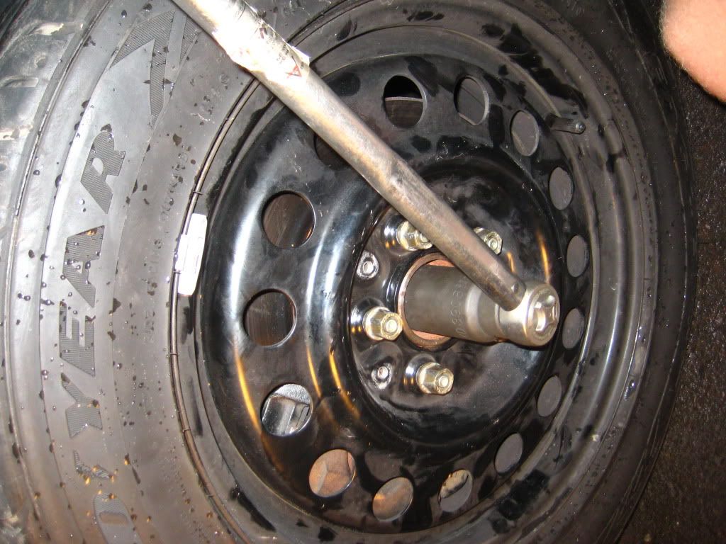

first remove center cap that is blocking your axle nut (35mm or 36mm will work too) IMPORTANT TORQUED TO 159lbs when replacing!!
loosen your axle nut 3 or 4 turn should be fine, do the same for your lugs

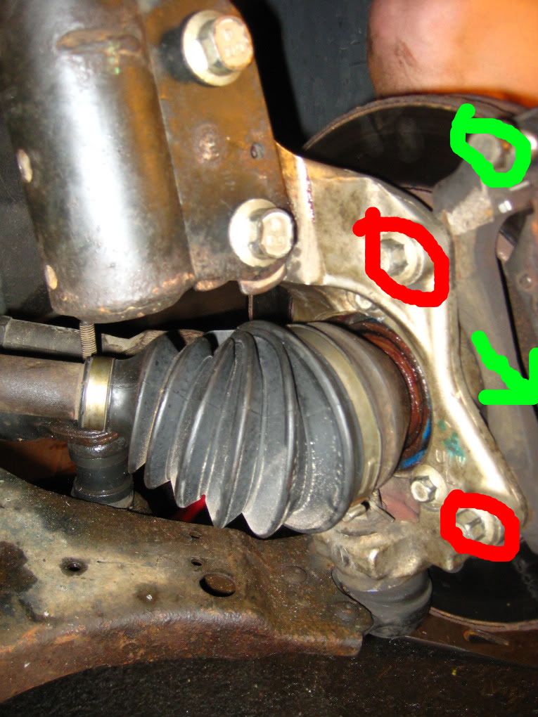

next is the brake caliper. you have two options you can either unbolt the piston (green) or the whole thing as one part (red) i find its easier to do the piston (GReen)then the bracket (Red)separately. they will both be 15mm sockets. Note you cannot use a deep socket for the top one as the strut will be in the way, so use a 10inch extension to get the top one.
support the piston with a wire on the strut (close hanger works best)

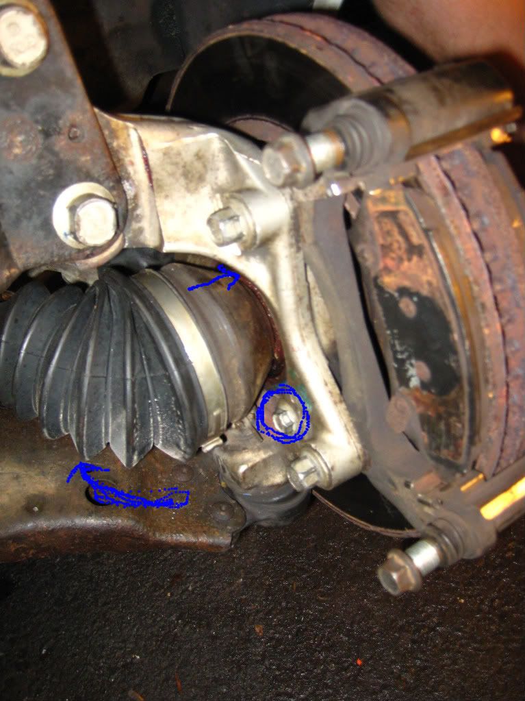

3 bolts that hold the wheel bearing in place. turn the wheel to get to these easier. they are 13mm only 2 are pictured (blue) the other is on the other side ..use a breaker bar!!

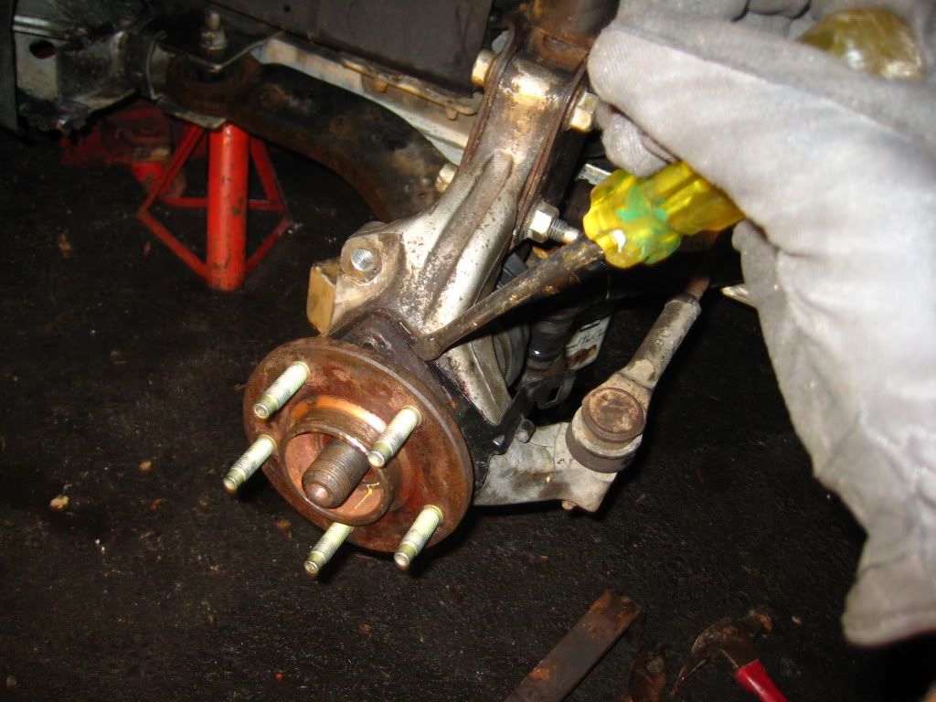

once you get those bolts out the bearing will be stuck in the knuckle ..use a big screw driver to tap this out tap with a hammer all the way around....once you do that then finish unscrewing the axle nut ....next hit the axle with the sludge hammer until it loosens up enough to pull the old bearing out

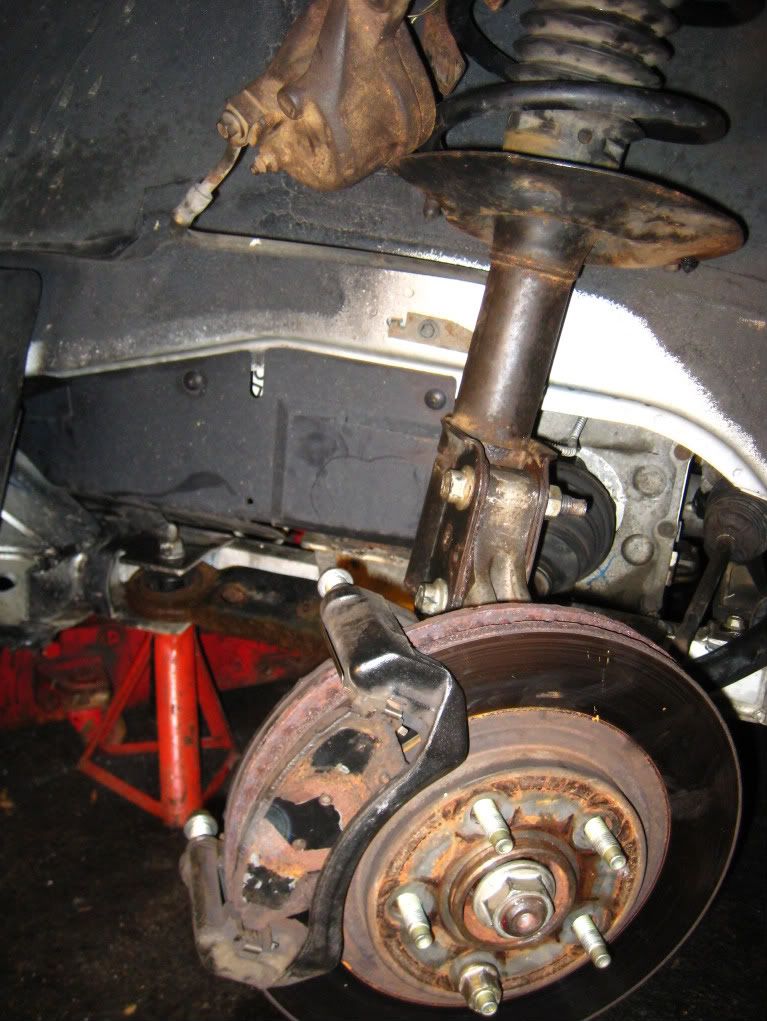

now we have to remove the top 2 bolts on the strut (MAKE SURE YOUR CALIPER IS SECURE!)

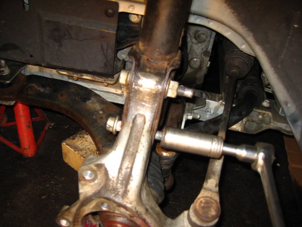

take the nuts off they are 3/4inch socket bolts....then get your sludge hammer and smack the bolts until they come loose and pop out the other end....THIS WILL SEEM SCARY! make sure your car is on jack stands and the jack as a backup..... you will need to hit them with some force.
