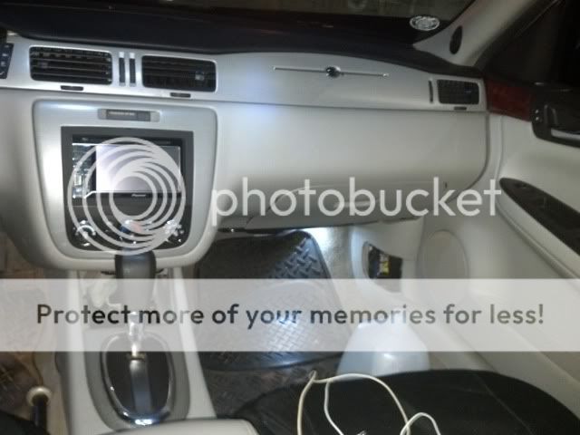

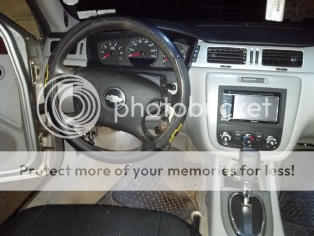

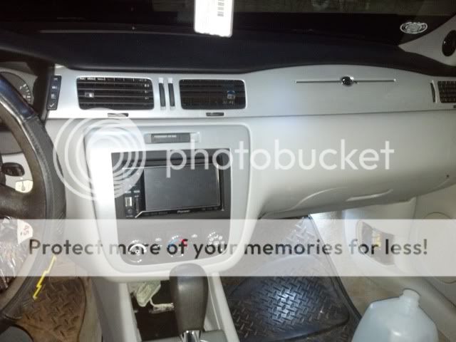

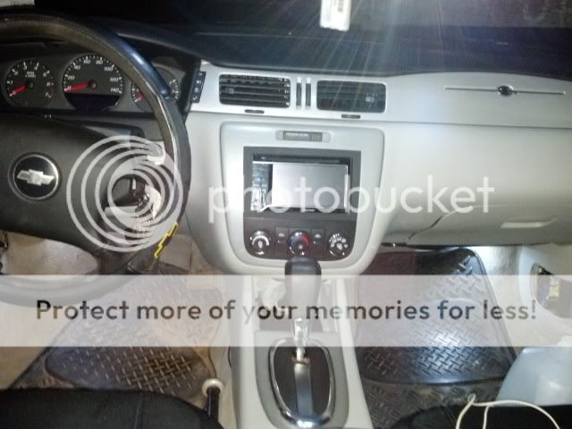

my 08 impala ls came with woodgrain dash, radio bezel, and shift bezel.
In my opinon this car is so damn dated and plain the woodgrain just makes me wanna puke. SO
I swapped it out and put in a bushed aluminum dash and radio bezel

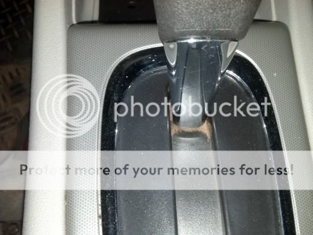

and a carbon fiber shifter bezel.
I would have went all carbon fiber but i couldnt find everything in carbon fiber on ebay:lol:
The dash peice is 2 bolts on either end and 2 screws in the top of the cluster and then clips
Shifter bezel is a clips just pry it off
Radio bezel is all clips just pry it off and unplug the airbag indicator.
The only woodgrain left is the little bit on the front doors which i will plastidip to match the black on the door panels
Install took no longer than 30min including removing the old shit
Also got all the parts used but in great shape off ebay for under $100 using the good old best offer button.
(BTW i did this last spring just never told anyone)

okay.
Drivers side
1. pop off the cover where the a/c comes to the door
2. unscrew screw
3. unscrew screws that hold the dash to the gauges(2screws)
Pass side
1. pop off same thing as drivers side
2. unscrew screw
then carefully pull the dash off toward you its not just left in with clips.
The impala logo piece is all one peice including the instrument panel bezel.
It literally goes aross the whole dash drivers side to passengers side.
