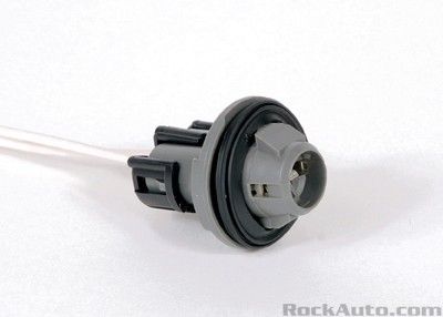

Should take out 2 screws that leads to the Lic light. That is in the bumper facing up. oNce they are out you removed the light from the rear bumper and then it is only there with wiring. Between the harness and light cover comes apart! Maybe you should take a picture of what you have as I don't know maybe someone before you got the car has changed out the part that is on many GM products even past our Gen of IMpala still has the same type of removal because they are somewhat the same...
Here is a Picture of what it would look like outside the light cover. Sorry I didn't go out to my cars, It is pouring down rain or I would have.
I will try and get out there if there is a Break in the Down pour today. If you are able to I would take a Picture of what your talking about so someone may better understand what your working with...
