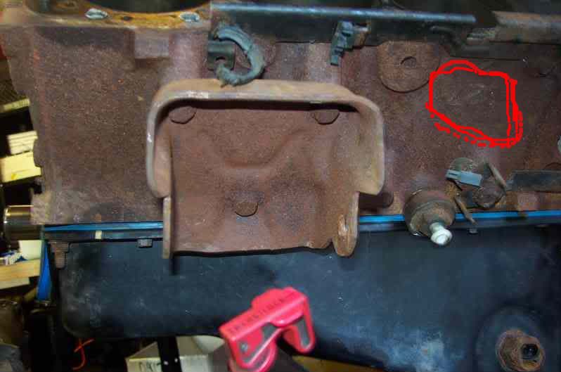

See the upside down "327" above the driver's side knock sensor. Well on an L99 that would be "588". I am specific in pointing out that location because there are other places on the L99 block that say "327"
I wish I had better documented the L99 block before I scrapped it, it is so missunderstood a few pictures could really help.
Here is a pic of the heads side by side, notice the difference in the width of the gap between chambers due to the smaller L99 bore. I took that pic because a VENDOR on the big forum was claiming LT1 and L99 heads were the exact same thing.
